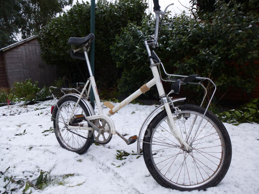

OK, my MIFA is finally here in London. A long story. The interesting thing is that it isn't a "klappi" - in some ways I'm happy, because the folding-hinge is (as many people here have said) a weak point, and I was going to weld it anyway.
Still a small mystery though. I'm pretty sure it's a MIFA - it has the badge on the front - but it doesn't look like a "converted" klappi, more like it has never been one. Did MIFA make a 20-zoll bike that wasn't a klappi? I haven't found one.
The chain ring looks wrong, but it does have the correct Renak rear hub. The mudguard paint-stripes are black, when most MIFAs have red stripes.
Can anyone help?

Geschrieben am: 03.02.2015, 16:16
Beiträge: 2873
Mitgliedsnummer.: 3839
Mitglied seit: 16.09.2010
Hm interesting. Mifa produced a lot of bikes for kids as well, just look here, maybe this? Its written there thats the same frame like Klappies one, except the folding-hinge. http://ddr-fahrradwiki.de/Mifa_Modell_401_L
