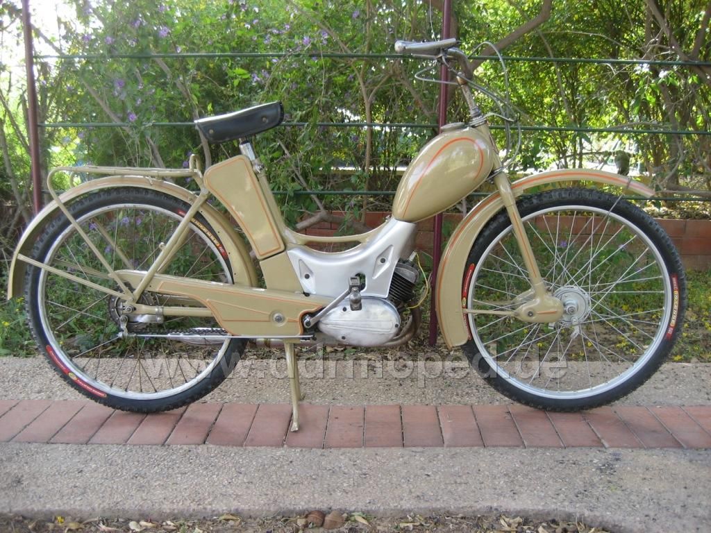

Hello to ddrmoped forum
It was superb, fantastic, gorgeous.
I did some rounds in the neighborhood it was after the carburetor drives me crazy.
Then by insert a small piece of bandage into the outside part of the air filter and by that reducing the amount of air the engine work perfect.
Of course there still work to make but I could resist the temptation to have a trial on it.
Ot the airfilter you have a lever/hand gear. Upright ist filter Closed (Z="Zu")Downward is filter open (A="Auf"). Cold engine=upward=closed=few air, warm engine=downward=right air.
You must still now mount the lights and the brake at front and of course, what joker sayed wink.gif biggrin.gif
regards Norbert

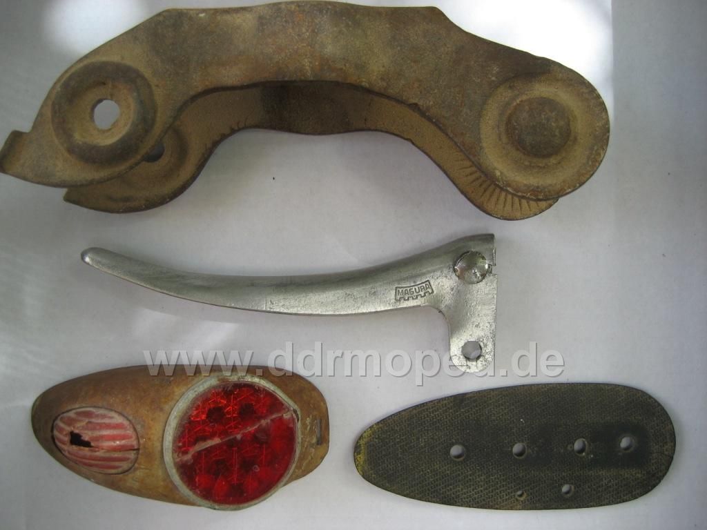

Those parts left:
The saddle must confess I throw away a years ago (didn’t know the value of it then) same as the rear bulb holder.
For the left handle I will use the sachs bike "magura" made In W.Germany (how much similarity between east and west at that time…).
Ori
