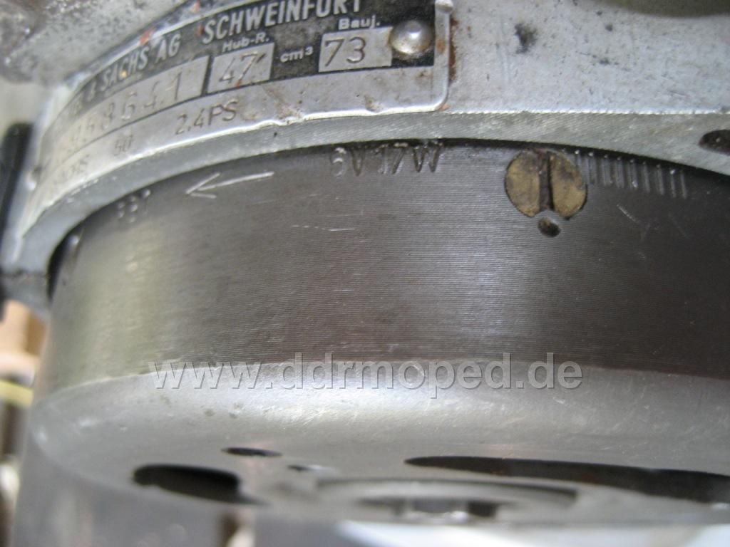

Please can you give me advice that form the sachs
You know I'm not mechanic
the fish wating for me 15 min
Thanks Ori
Norbert you made the announcement for me if I will came there will not be excuse for those how living far laugh.gif laugh.gif laugh.gif
Geschrieben am: 09.04.2008, 23:54
Ori, well: now you can not be ducking laugh.gif Now its officielly laugh.gif
In your picture is show a clutch from sachs engine. Don`t want a new one. It locks allright!! Its really in order and its alright!! Thats, what I can see.

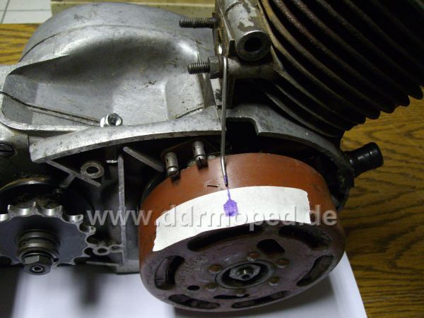

Hello everybody

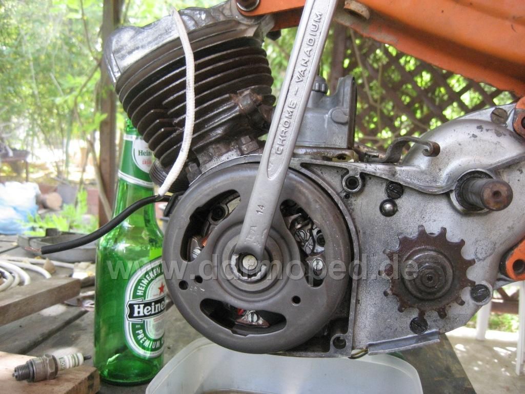

here is a small trick that I found in the internet to lock the motor and take out the flywheel by using a Cotton rope down the spark plug hole.
Beside I found a political question why the W-E Germany motors inverted.
Regard
Ori

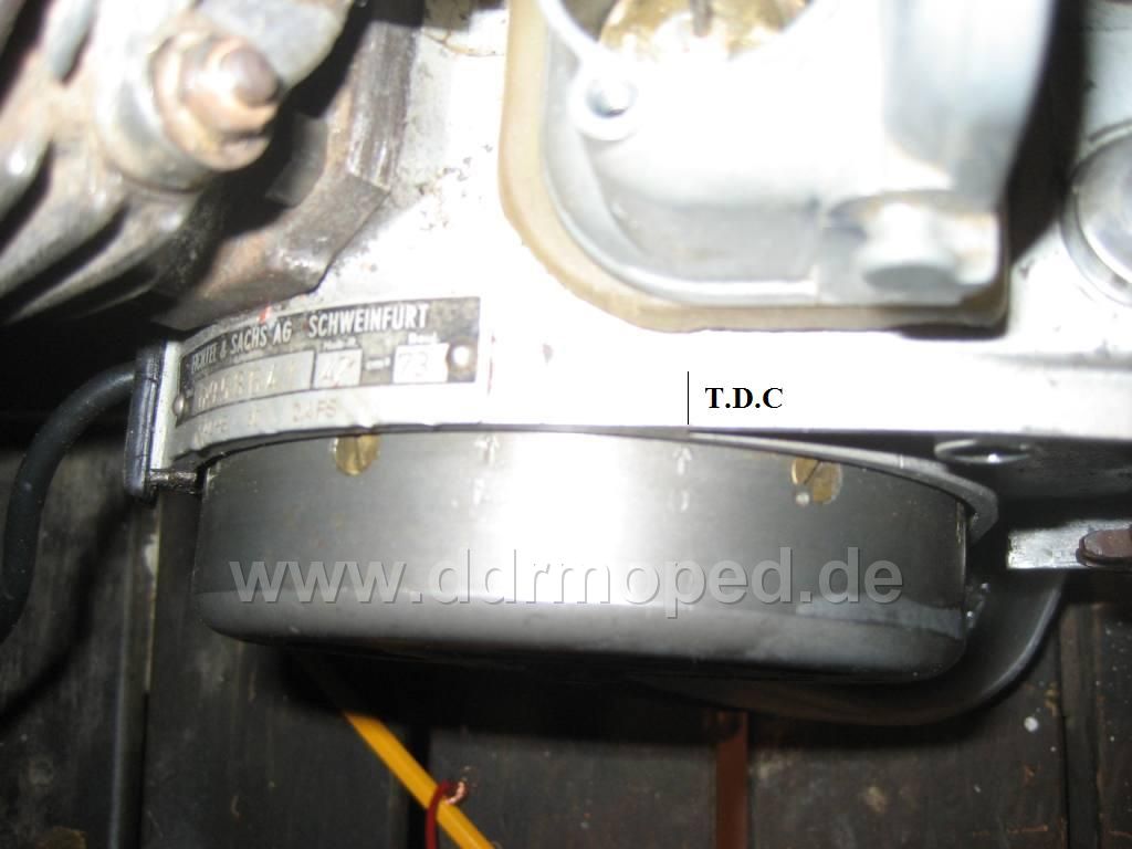

I know it Sachs … but I real dummy with this.
How I fix the Ignition Contact "Unterbrecher" I get very good power for the lamp
But a very weak spark or nothing
If anyone can assist
Thanks
ORI
Geschrieben am: 13.04.2008, 16:17
So that I mean, the sachs ignition has a space at contact braker of 0,5mm. But I don`nt know the ignition time. Sorry. rolleyes.gif

QUOTE (ori_s @ 13. Apr 2008, 15:14)
Hi Ori,
this trick is at Simson-SR-Motors not necessary, because the flywheel is good accessible for grip.
Look at Heikos picture:

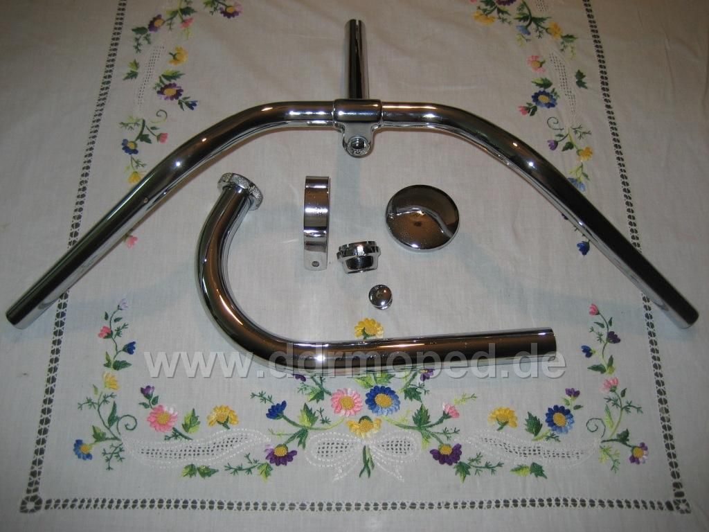

this parts are honey to my soul laugh.gif (and a very nice table cloth. What`s your wife thinking about this violation laugh.gif ) Your link to jewish oldie-scene is also very well thumbsup.gif Many intresting machines are there. thumbsup.gif Ì don`nt have know it.

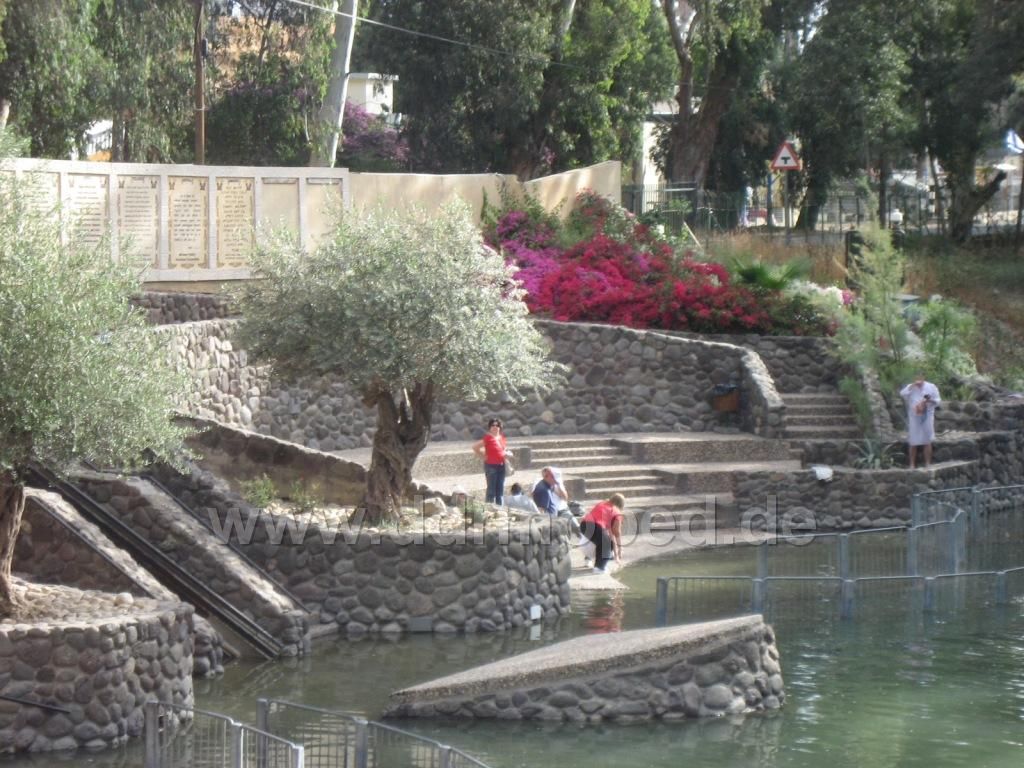

Second you need to conceder that Jesus from Nazareth spoke Hebrew. Look for the photo where I been today. biggrin.gif

I rely don't know if you want it.

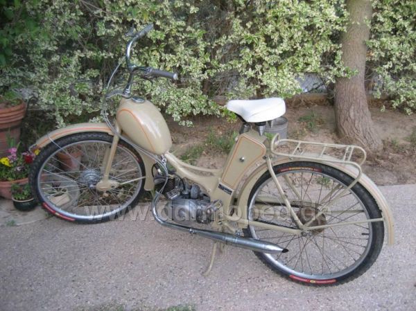

Hello everybody
First I like to congratulate Tobi that give is willingness to assist: _clap_1.gif _clap_1.gif _clap_1.gif
https://www.ddrmoped.de/blog/online-shop/weltweiter-versand
And that the link for small video.
http://www.youtube.com/watch?v=WmPM-CO8UpI&feature=user laugh.gif
Regards
Ori
Geschrieben am: 19.04.2008, 19:23
Ori, (I´ve sended you a mail just`n time)you have great weather in israel thumbsup.gif
In any times ago I want also take a bath in jordan river. biggrin.gif But its very expensive make a journey to israel.
The video is also great thumbsup.gif Please send it to me or Tobi for the drrmoped-site.
regards Norbert
