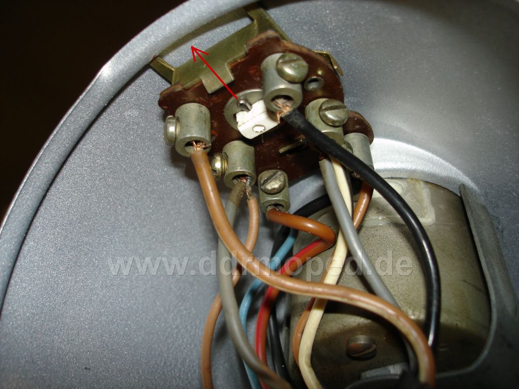

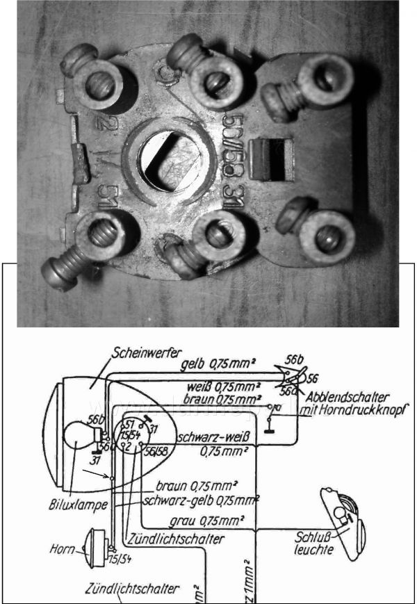

How do I remove the switch from the front light housing? I couldn't work it out from looking at it and I didn't want to break anything by trying without knowing for sure. Also, are the wirig connection numbers written onto the switch? _uhm.gif

QUOTE (Tomarse @ 11.01.2012, 15:53)
First pull the pin out of the button from the switch:

Geschrieben am: 12.01.2012, 17:21
Beiträge: 2979
Mitgliedsnummer.: 195
Mitglied seit: 14.01.2006
And the connection numbers are written onto the switch:
