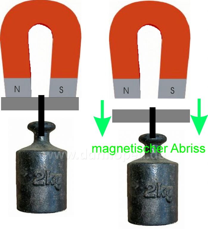

A picture says more than 1000 words.
That means " magnetischer Abriss " (magnetic demolition):
I have devised a plan for measuring this distance and setting up my timing reasonably accurately. I'm waiting for a few tools to be delivered and then I will update with my progress and the technique. cool.gif
