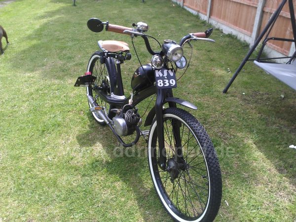

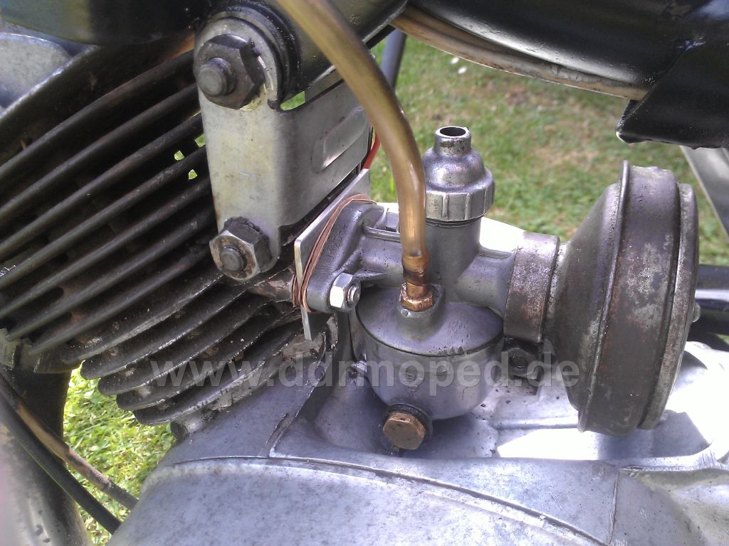

Hi again Norbert and thanks for the reply, yes a 250 may would end up with the madhouse lol ohmy.gif this is the pic of the engine after yesterday blink.gif

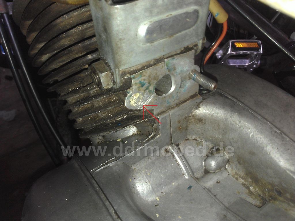

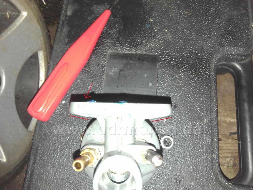

I think a lot of the problem at the moment is that when i tighten the carb the studs are being pulled at an angle and therefore breaking the weld (see Pic). although the weld i purchased from motosave i don't think is very good so i have bought a really good one and am waiting for it to arrive. then i am going to have 1 more attempt and re drill and set it again and maybe use my mini cutting disk to try to flatten the carb side where the studs tighten.

Thanks for the pictures, I thinked so.
The reason why of bended angels of the carb is fixing this to hard. Many of carbs looking so. Its aluminium and underneeth the carb is a plastic disc. In the original internal describtion the simson boys write "a little bit more than hand fixed"
Now you need a new 5mm hole with a 6mm winding. This is`nt on this place possibil with a machine. I cutted there with 2 cuts with the dremel and a minicutter a slot, removed the old bold and put a new one in. Than 2-component aluminium fluid or knead metal into and it works till today.
Try it, I´m shure it works also at your engine.
And yes, you can try to make the "ears" from the carb a little bit flat.
A carb with 9mm bore size is`nt enough for the SR2 engine. It works at a quikly, yeah, but the quickly is a west german moped. Nothing of power. laugh.gif

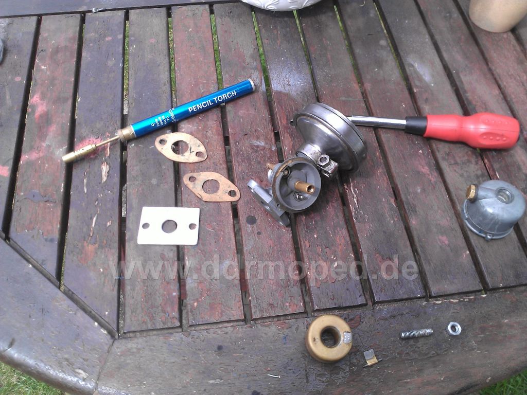

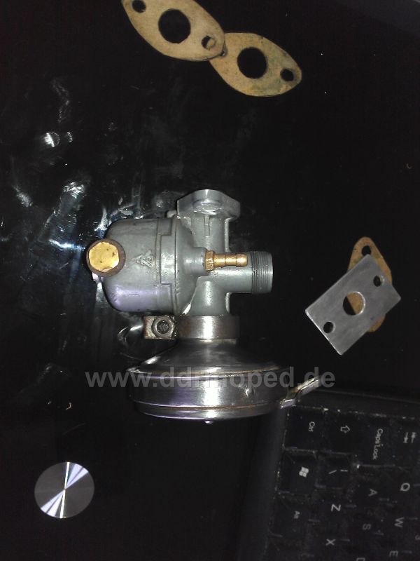

yes when i had the carb fitted i used gaskets and a spacer but i had to manufacture a spacer out of aluminium as the original was broken although it was only 3mm thick would this make a difference? (see pic) the hole that was drilled is too big for a 6mm thread and so i am having to try to cold weld it in (still waiting for the new cold weld to be delivered) Mark

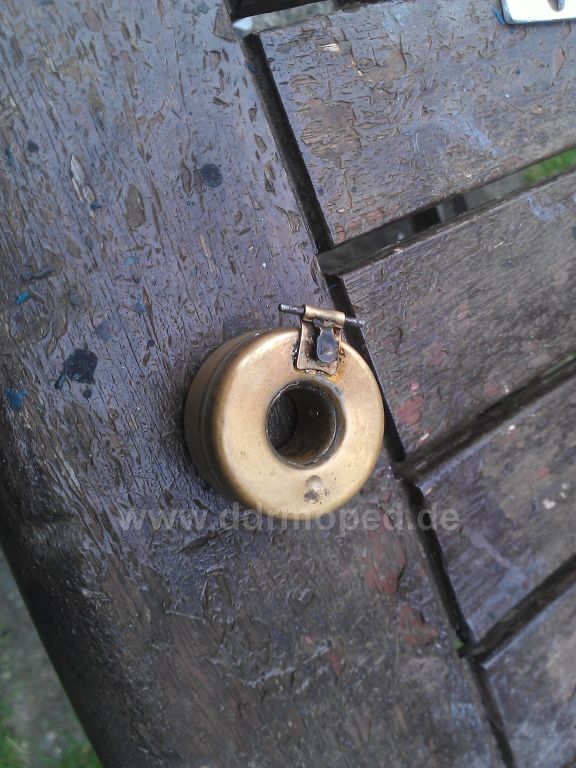

Norbert i have flattened the carb ears now and it seems to be a better fitting and i had already cut a 6mm bold down as a stud and am now waiting on the better cold weld. but then as usual with me (crisis time) the float fell apart cry.gif as you can see in the pic. So out with the torch and slodered it back together _clap_1.gif
I now have the float adjusted and refitted and yay no leaks how well it will work however is to be seen. and yes i have ordered the 2 part weld as i think it will be a stronger bond. meanwhile im shopping for a new gasket set and spacer.

The repaired float

And the carb re-assembled thumbsup.gif with the ears flattened

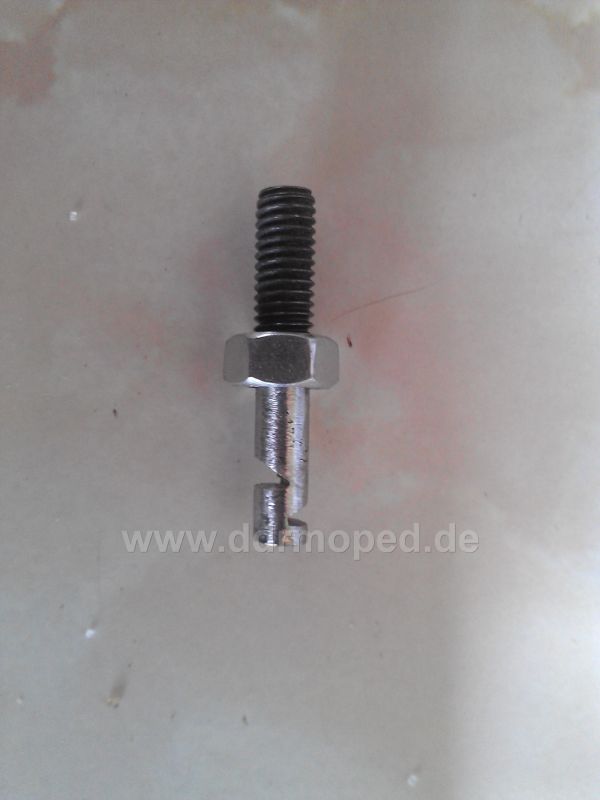

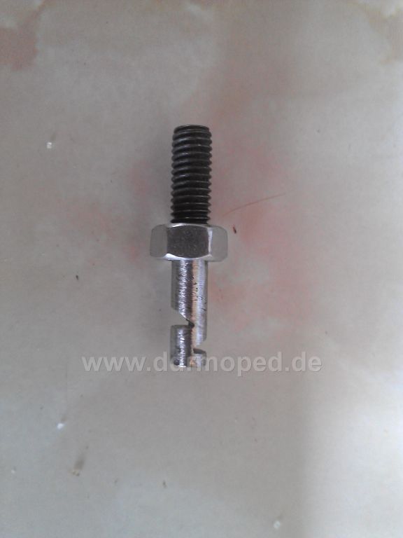

And have just manufactured the new head stud ready to cold weld into the barrel i have cut notches into the end to be welded to aid with the bonding. I LOVE MY DREMEL thumbsup.gif biggrin.gif

I can see your picture one of this site two and I don`t think you have a bigger input on your carb. But its not so important.
