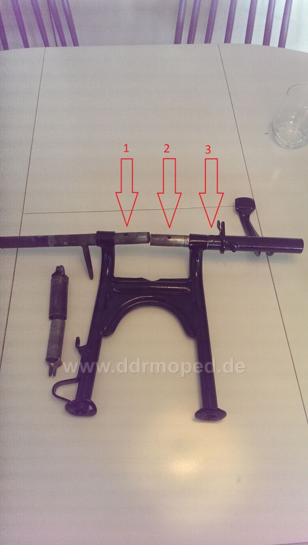

Hi all, I am now starting to building up my MZ RT 125. I have all the elements and the parts list, but I need some help with choosing the right parts into right holes. I want to install the stand to the frame, and I have three holes as presented in the photo. To my mind, I should use accordingly:
1: 'Zylinderkerbstift 5 x 32 DIN 1473'
2: 'Zylinderkerbstift 5 x 32 DIN 1473'
3: 'Splint 4 x 50 DIN 94'
Thanks!

Oh come on! I am sure that anyone working with this motorcycle has installed one of these. Anyone?

Hello,
2. Where are you from?
3. What´s your first name?
4. Which construction year is your RT?
My english is really bad, sorry.
In my part list is at 3: "Kerbstift 5x32", too.
I´am think the list is older than my RT.
