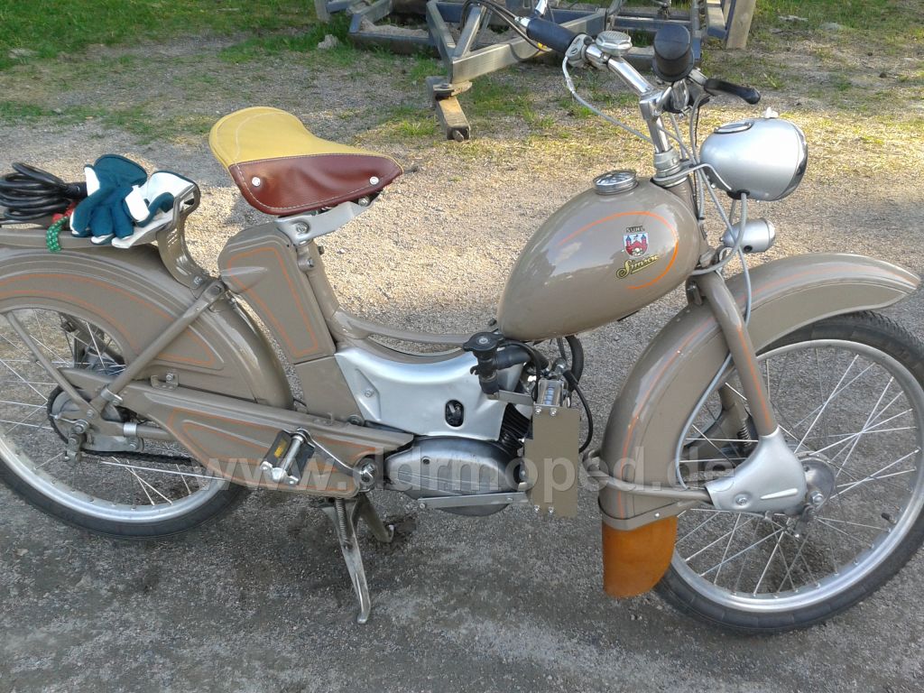

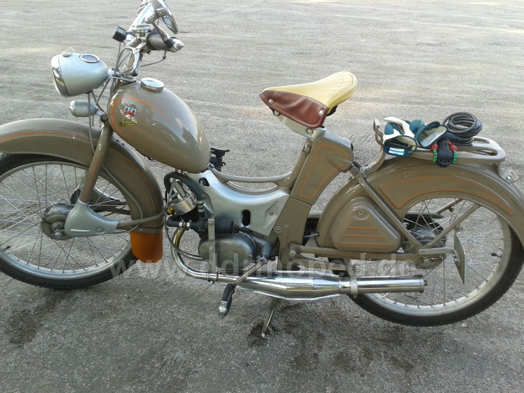

I have also one other -63 SR2E which is customized with my own specs and its built more like original bike. Its got watercooled cylinderhead and reed valve contol in original engine. Dont have too many pics, but i can post them from my phone if you like to see?

Here was fair amount export Essis in sixtys and you can still find some frames. All the restoration parts ofcource have to order from Germany or made by own. I can ad some tech pics.

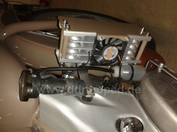

Mitglied seit: 22.08.2015

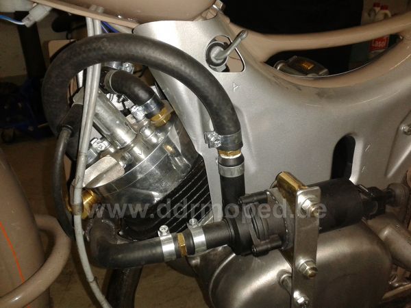

Its got Power dynamo 12v electrics with better voltage regulator, so i can run this waterpump.

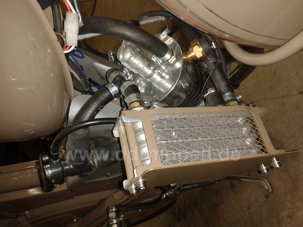

Radiator is some chinese made oilcooler. Total water capacity is 0,28 liters. laugh.gif
Fan is brushless computerfan and filler neck is customized from Honda fireblade. Fan is controlled by switch from daihatsu car.

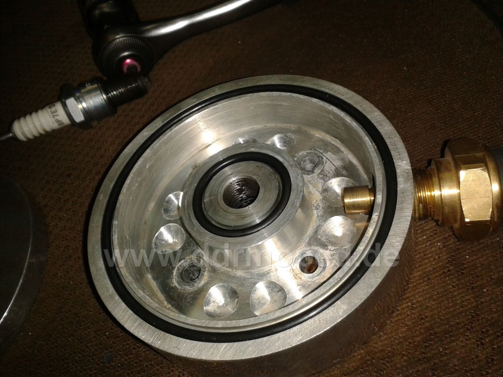

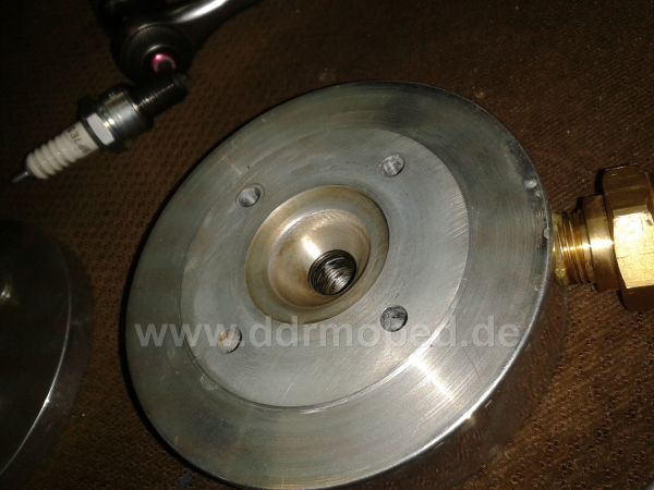

cylinder head made out of 110mm aluminium bar.

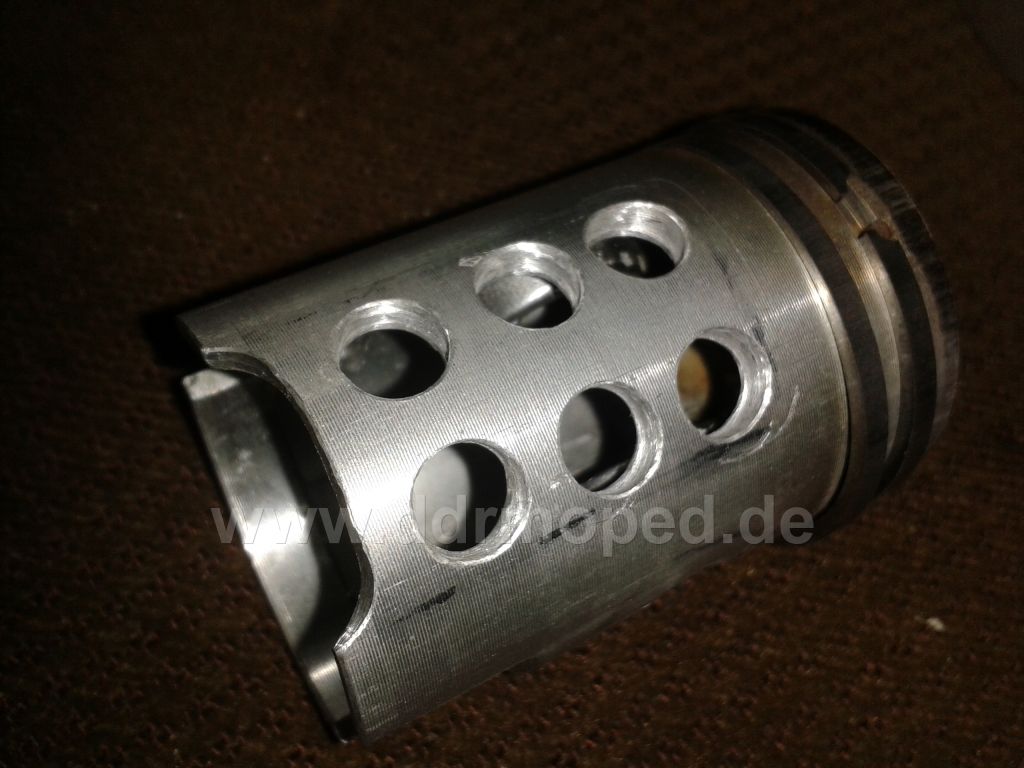

since i use reed valve, i released piston skirt timing and made piston look like cheese biggrin.gif

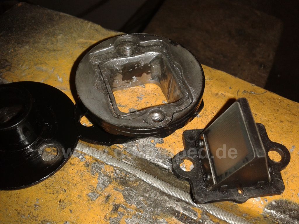

Reed valve from DLE20 rc engine and intake manifold between carb and engine.

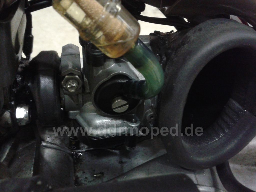

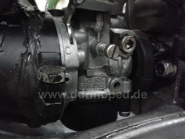

14mm Dellorto SHA. Did some modication to it make it work properly.
