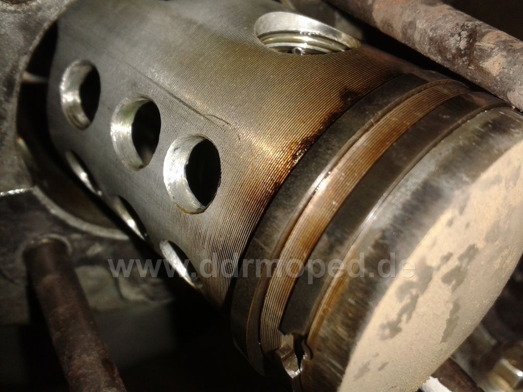

It goes 53-54 Km/h on flat surface and 14 front sprocket. Its enough speed with this original engine. All modifications aiming for good torque, which you have to have with only two speed gearbox.
It feels very strong when cold/half warm engine, but now im losing torque when engine is hot. Especially after some flat out running.

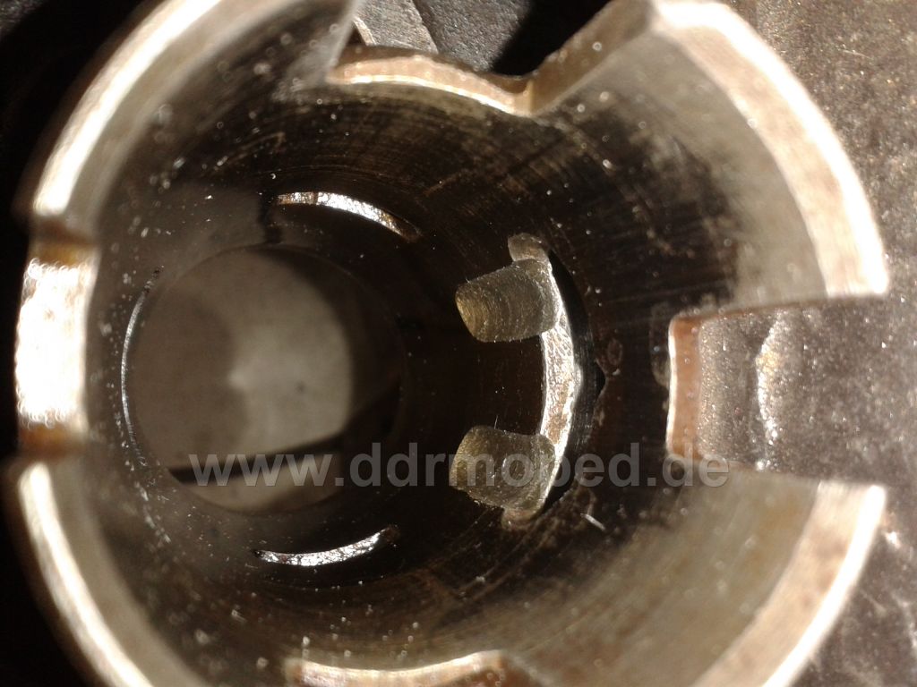

I think i have too much compression ratio and im planning to drop some and also noticed i have blow by thru piston rings. It warms up intake air in cranckcase. Pistonrings feels like not compressing enough, so im looking some replacement piston for this aplication. Any hints for this? Thinner pistonrings preferred. Like new engines have.
Here you can see sign of blow by behind piston rings. Is it normal with stock engines?

You can see also from piston crown that its catching cylinder wall. Too much heat expansion here.

Blow by behind the piston rings happens. With my previous used engine i drove long time with this minimal blow by.
If you want to reduce the compression you could try a Gasket like this. Originally there is no gasket, but a gasket will lower the compression a little bit.

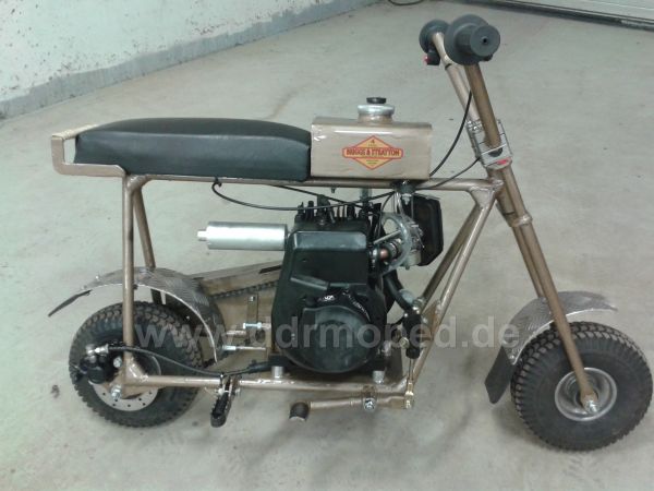

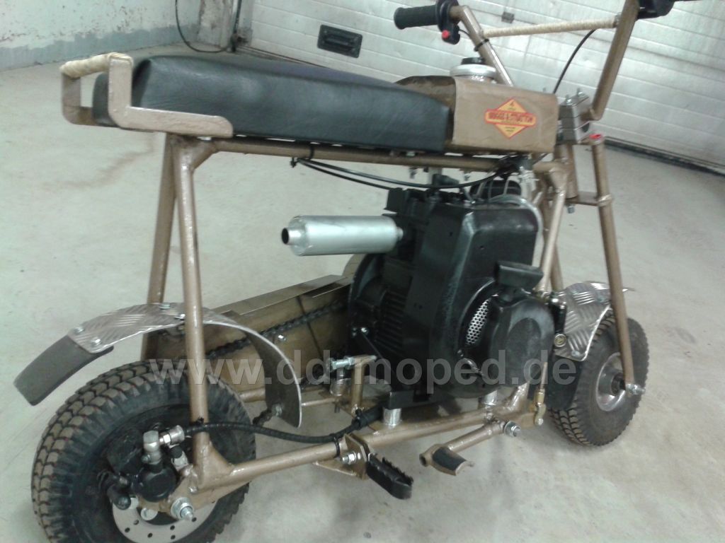

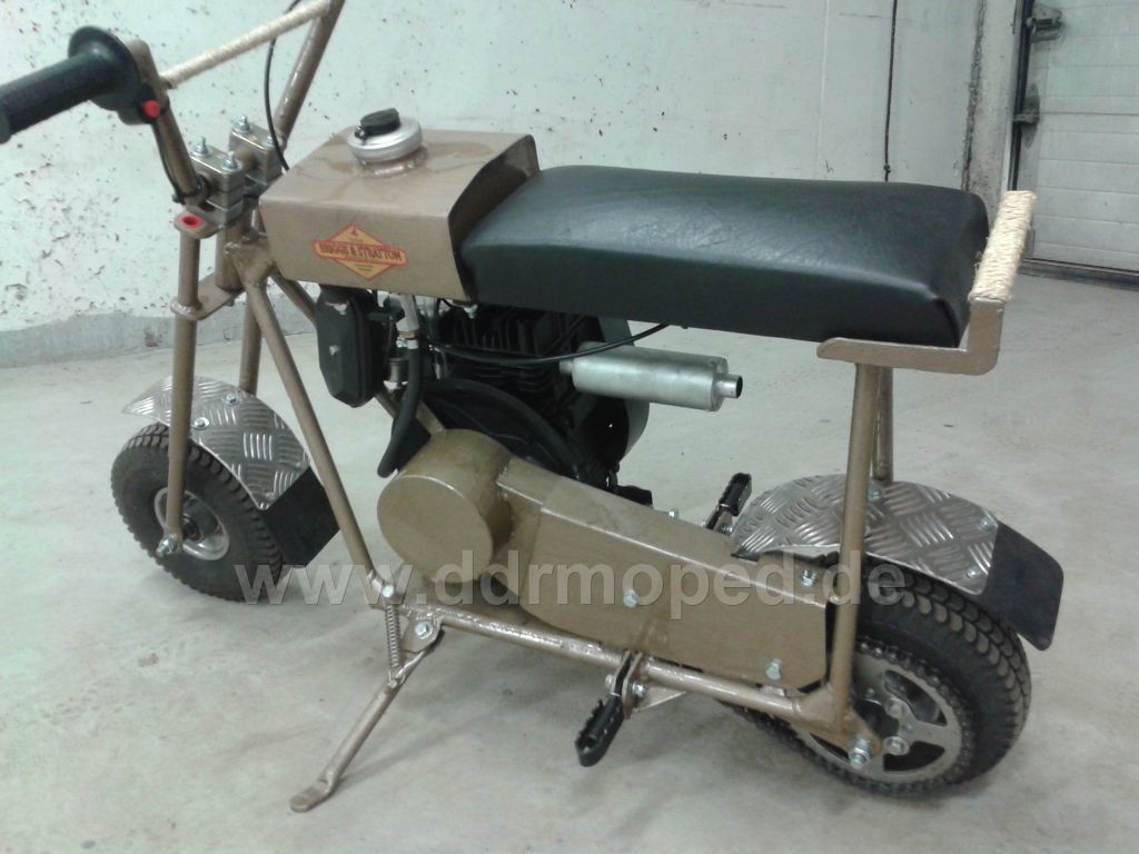

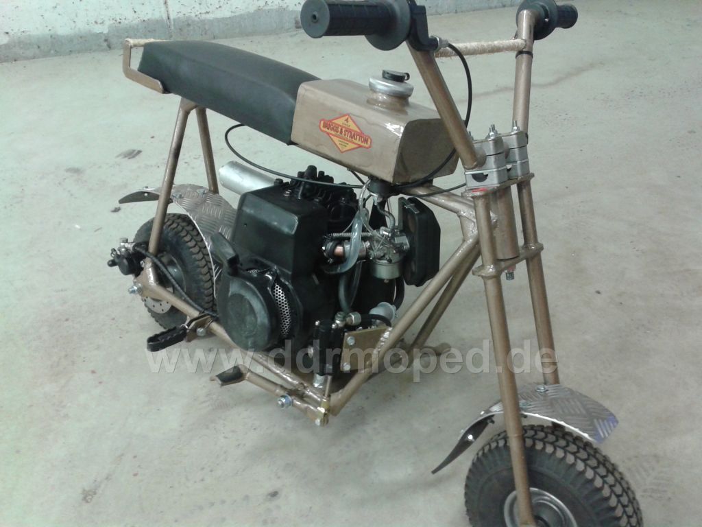

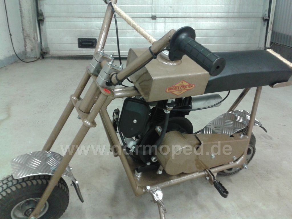

Im sorry to input simson unrelated pics here on this site, but as some one here said you like pics, i send some more my projects. Colour theme is ispired from SR2 so it will fit in this continue, i guess laugh.gif Brush painted budget trainee bike for kids.
fsvaasam
Geschrieben am: 06.04.2018, 19:47
Beiträge: 36
Mitgliedsnummer.: 8376
Mitglied seit: 22.08.2015
2.
fsvaasam
Geschrieben am: 06.04.2018, 19:49
Beiträge: 36
3.
fsvaasam
Geschrieben am: 06.04.2018, 19:50
Beiträge: 36
4.
fsvaasam
Geschrieben am: 06.04.2018, 19:51
Beiträge: 36
5.
