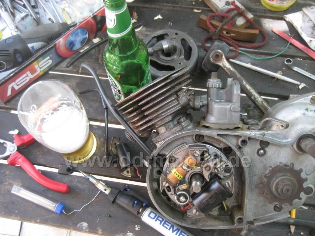

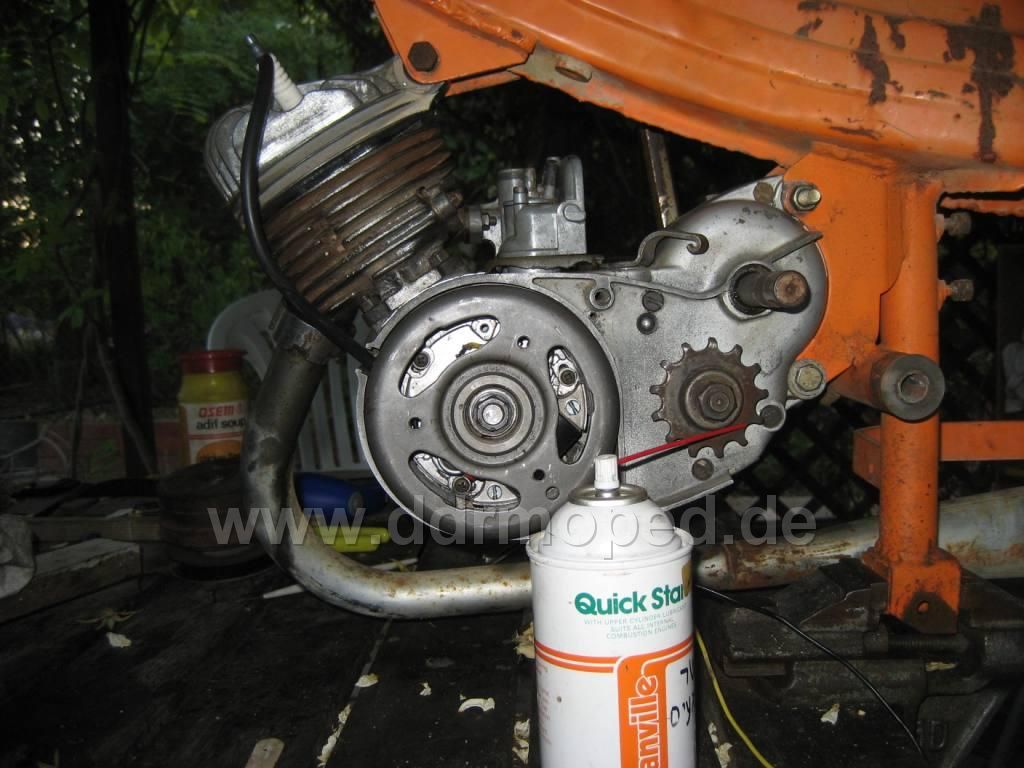

Hallo jeder
Norbert or anyone willing to assist
Although I change the coil (used one) in the Sachs motor I still get a weak spark only when I touch the plug cable to the motor with the plug nothing. _uhm.gif
So what it could be what the function of the "kondensator" is?
danke schön
Ori
ori_s
Geschrieben am: 02.05.2008, 16:52
Beiträge: 545
Mitgliedsnummer.: 1087
Mitglied seit: 08.02.2008
Hallo jeder
Finally I help myself with beer it wasn't the coil it was the contact that was need to chip from a fine corrosion
The f….g Sachs now working and have a long blue spark till the moon. so I promise not to nagging anymore.
Regards
Ori

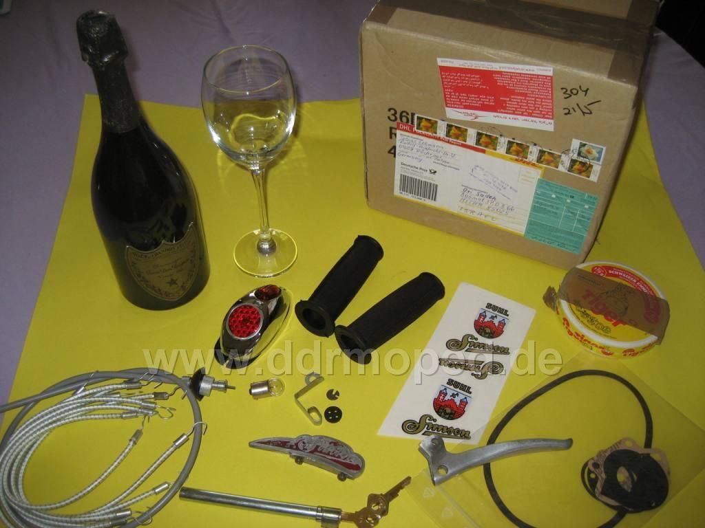

Hello Tobi and all of the forum members
After one month exactly I received the parcel from you.
I join the Dom perignon 1985 Champagne because only me, you and Norbert knows how tense it was this long waiting (many emails and even a phone call to Norbert home).
I like to thanks upon this thread to you and Norbert for yours special care and effort. _clap_1.gif _clap_1.gif _clap_1.gif
Sincerely
Ori

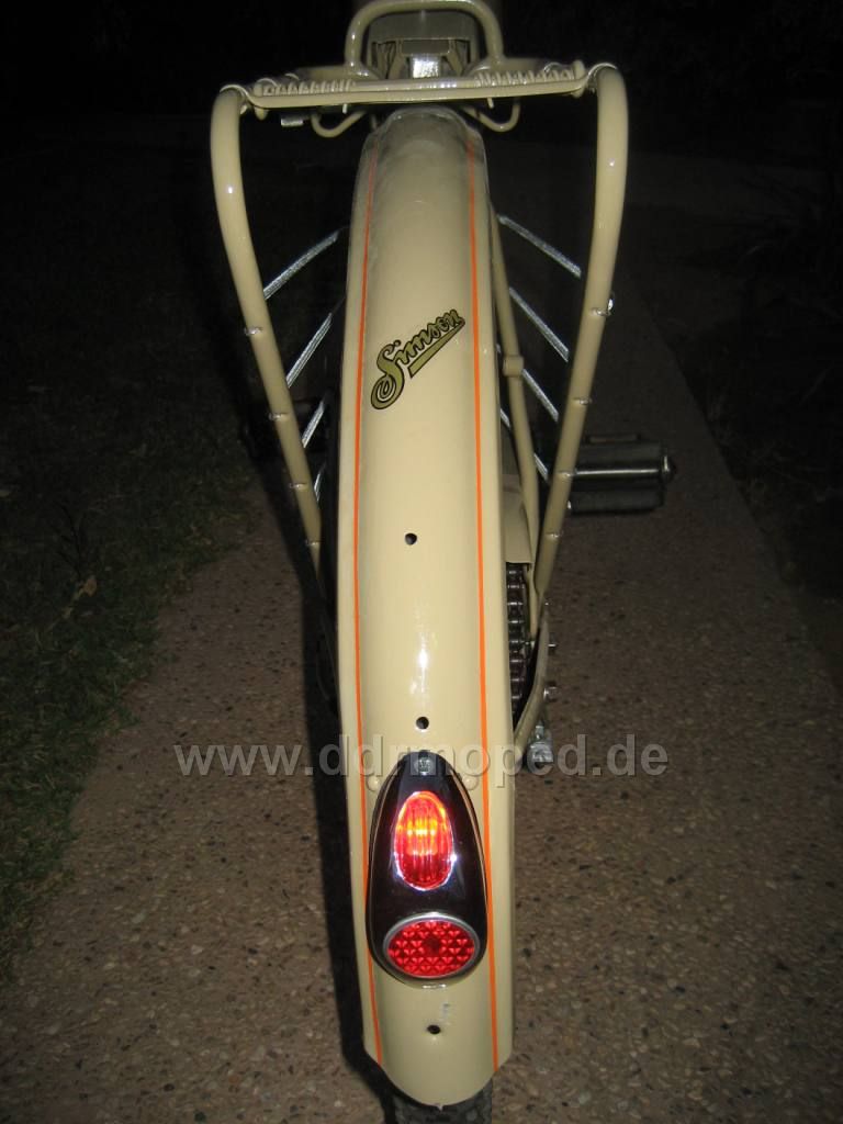

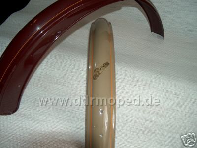

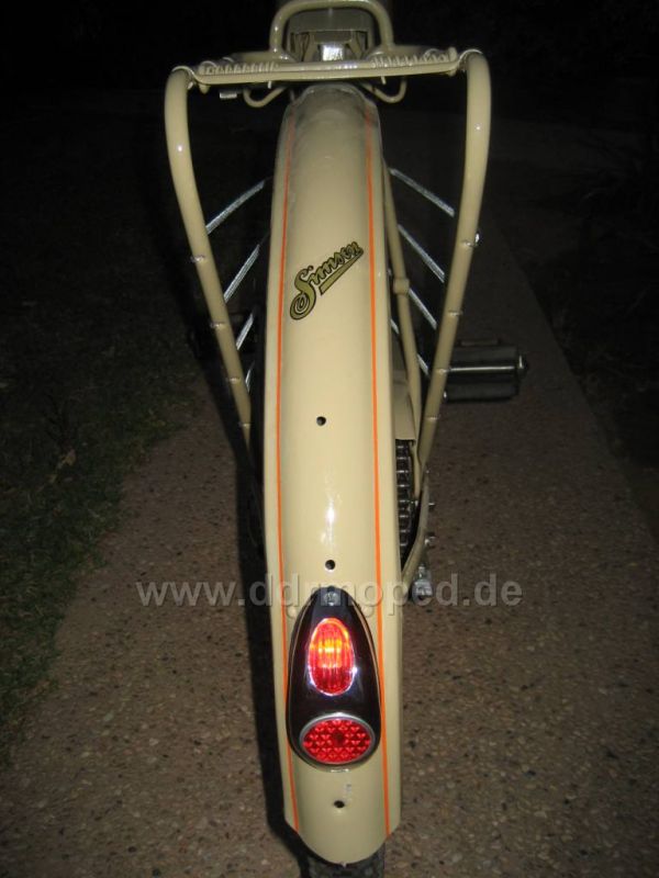

Geschrieben am: 22.05.2008, 20:08
Ori, my friend,
yes of course. germany is the country where riesling was born. laugh.gif thumbsup.gif
But why you don`t asked for a photo of simson-logo on rearside ? Yours is to high!!
Also the two holes (they are odd!) for srews are suspect. Very suspect...most.... laugh.gif
ori_s
Geschrieben am: 22.05.2008, 20:50
Beiträge: 545
Norbert
You right it high by 3-4 cm, the holes made for an Israeli license number.
I check the number in the office of transportation and I found that it belong for a track from 1948. I suspect that the owner take some number from a passing track because as we know the SR1 like other bikes was no need for a license and consider as a bicycle with a helping motor later on the rolls change so this why I have a problem to put it on the road I try to check even by the buddy and motor number but nothing.
