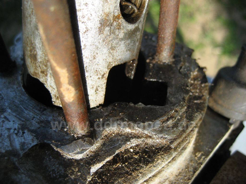

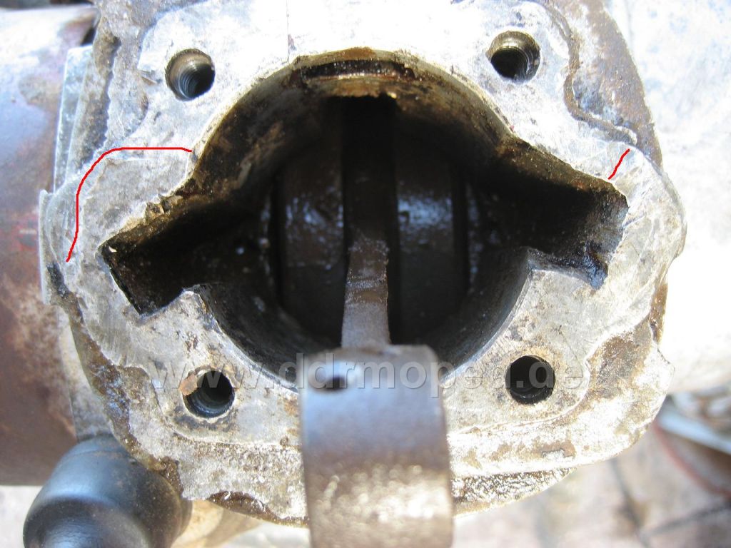

Hello friends
Need advice the gasket firmly attach the edges of the aluminum are broken.
I think the motor is "getan" weep.gif Is that so?
Thanks
Ori
ori_s
Geschrieben am: 22.03.2009, 15:30
Beiträge: 545
Mitgliedsnummer.: 1087
Mitglied seit: 08.02.2008
pic2
Geschrieben am: 22.03.2009, 15:32
Hello Ori,
I don´t think so. Screw the bolts out and mill it plane. But then you need a gasket in the right thickness. Or you will have more compression. biggrin.gif

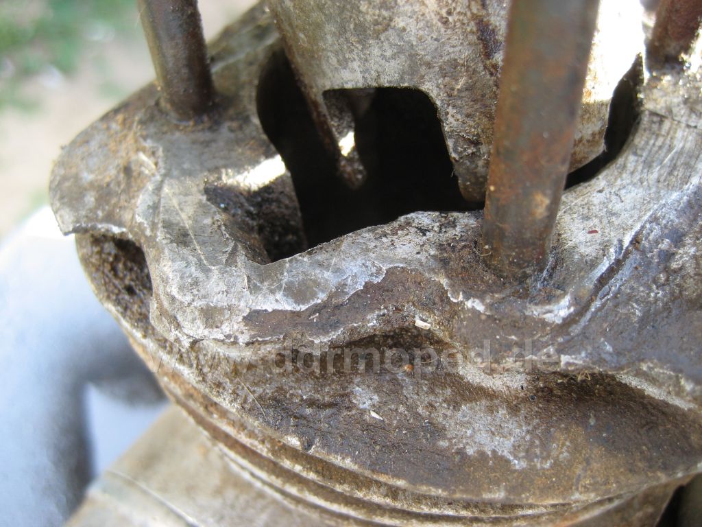

pic3
ori_s
Geschrieben am: 22.03.2009, 15:37
Beiträge: 545
Thanks Der Tim
I don’t think it possible easily to remove the old gasket and the all area not flat.
but i will do take the piston and the screw out and see.
Ori
Geschrieben am: 22.03.2009, 15:57
Oh, I don´t see it, is it an aluminium gasket?

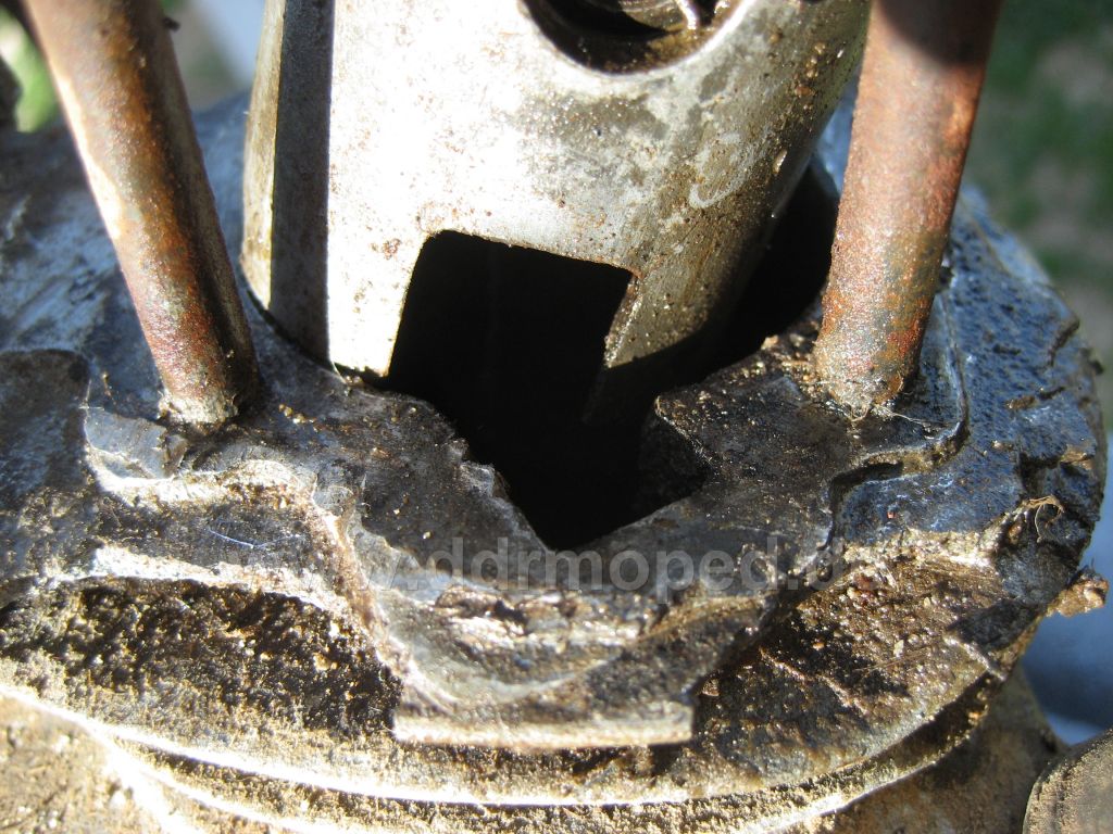

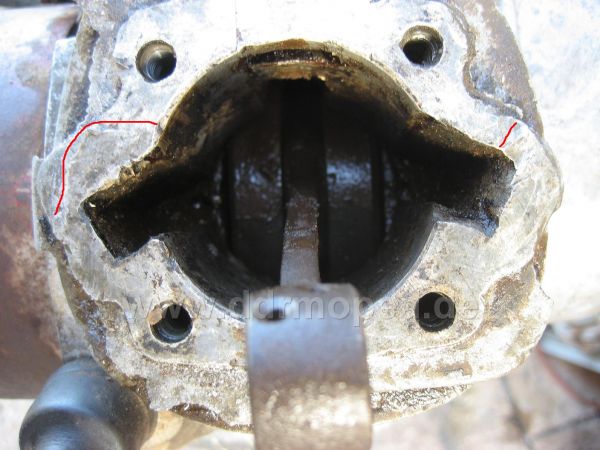

ori_s
Geschrieben am: 22.03.2009, 16:46
Beiträge: 545
I don’t know if those remains of the gasket here?
I scratch with sharp knife and it soft aluminum.
I fill up the crank house full of oil because it not turning easily.
It will be a story. No cylinder no head no right motor cover how is the magneto? How is the gear? hmm.gif
At list the carburetor looks good.
Maybe this what I need: http://cgi.ebay.de/Simson-Motor-SR-SR1-SR2...7C240%3A1318Ori
Geschrieben am: 22.03.2009, 18:47
I don´t know. It doesn´t look like an aluminium gasket but it could be one. I would say grind it plane.
I hope you won´t to use the crankshaft again, look at the conrod it´s twisted.
Der (=the wink.gif ) Tim

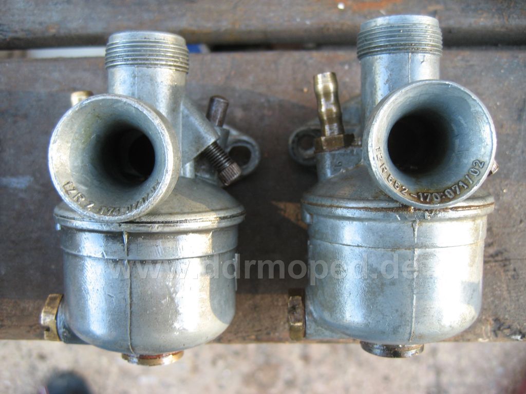

Hello fiends
Now when I have some play ground unlike you plays alone on other planet.
I exams the carburetors, the right one works better.
But only god and some of you wink.gif know what those numbers say.
Ori

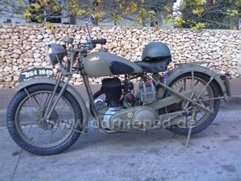

Gast
Geschrieben am: 26.03.2009, 17:37
Hello Ori, do you have more pictures of the green bsa (w) m 20 ??? a friend of me has the same bike but in bad condition...
Fidel
ori_s
Geschrieben am: 26.03.2009, 18:55
Beiträge: 545
Hello Fidel
The military version WD-M20 (1939-1945) 496cc
Try : http://images.google.com
Ori
