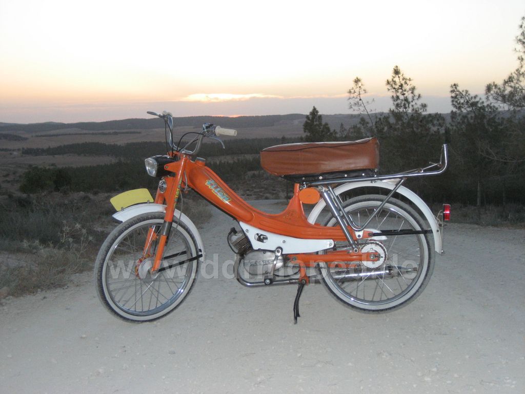

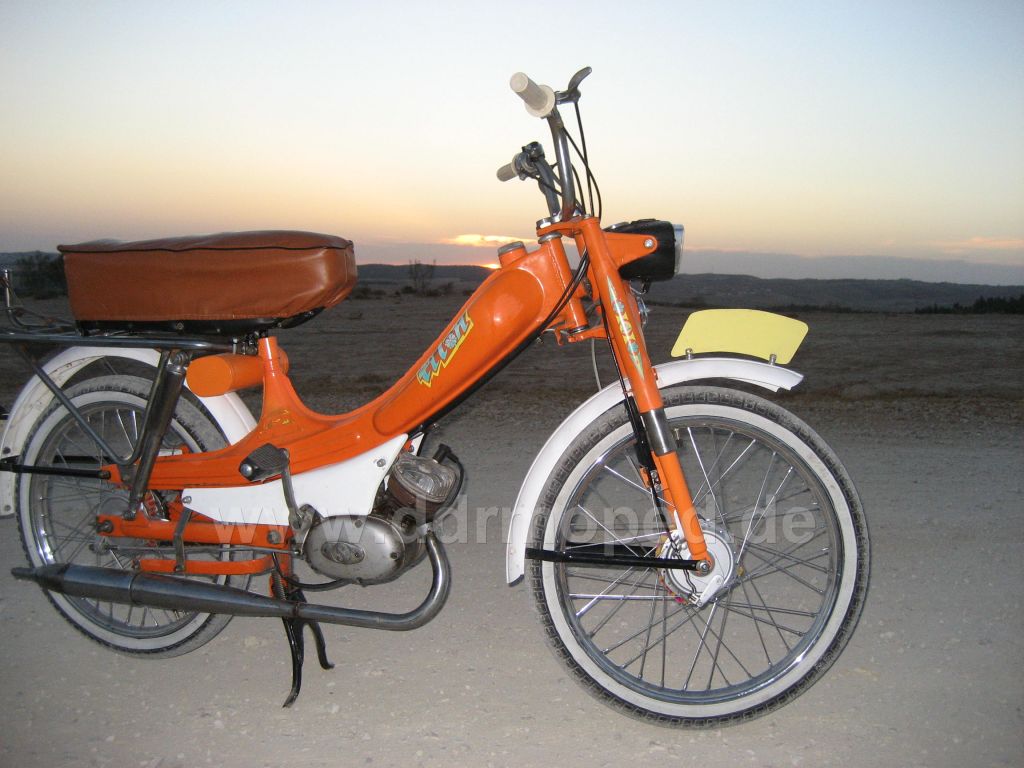

Hello friends,
After Angela and Barak visit that broadcast live, in a place not away from our UT.
When the day heat off, I take some fresh air.
Ori

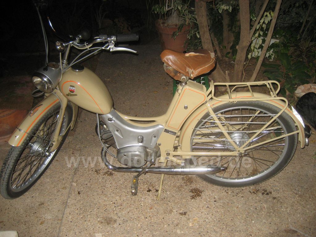

Achilles Capri (W Germany 55-57) based - Israeli Tilon 1975 (Sachs 2.4 ps)moped.

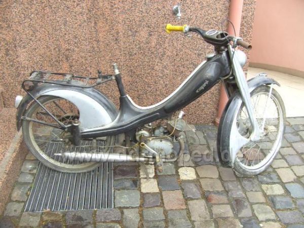

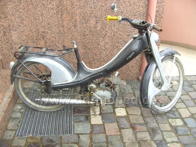

Achilles Capri 1957 belongs to my friend Hubert from Bermersheim Rheinhessen-Pfalz.
Geschrieben am: 05.06.2009, 21:38
Beiträge: 14959
(Huberts phone is ringing, an nobody is going on. I try every day often and I try again...and again..and again...)

I don’t know what language this motor talking "for sure" (Norbert) not Indonesian, I try it also. laugh.gif
But after replacement 2 pistons 2 Carburetor and 2 spark plugs it works properly.

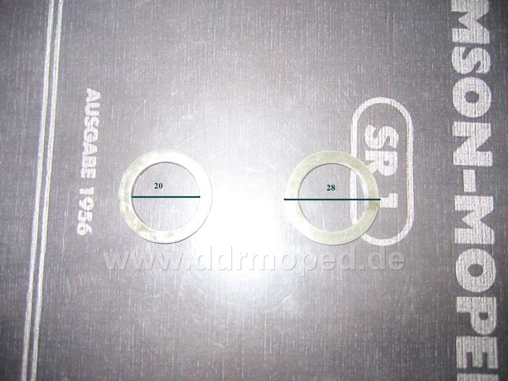

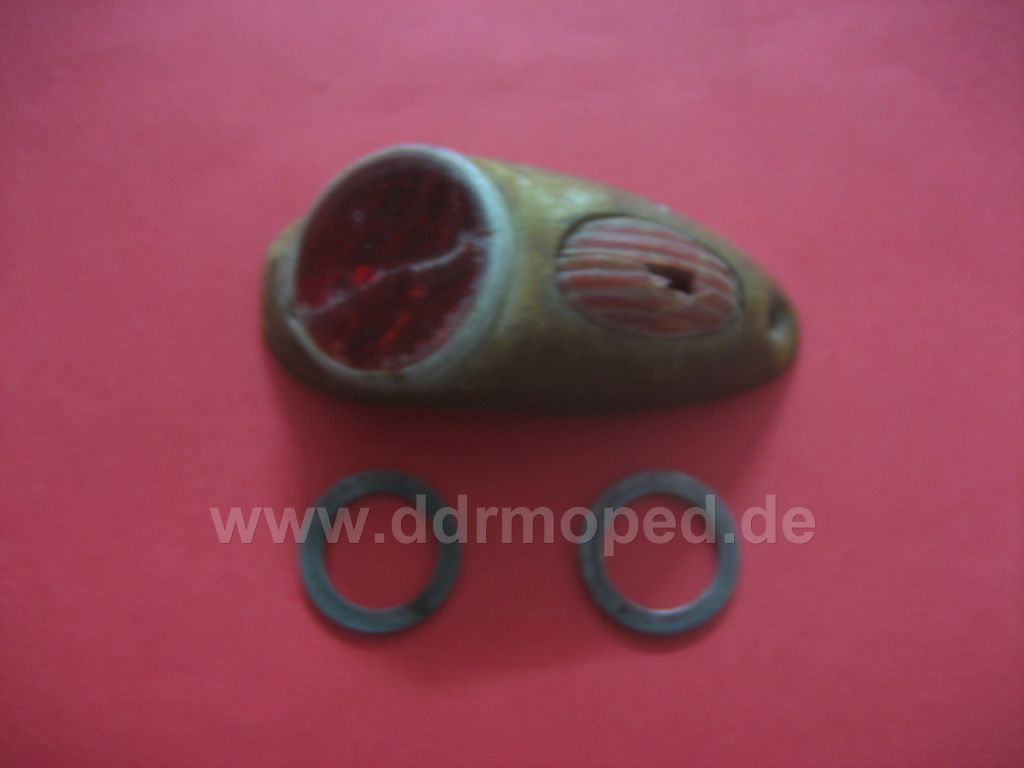

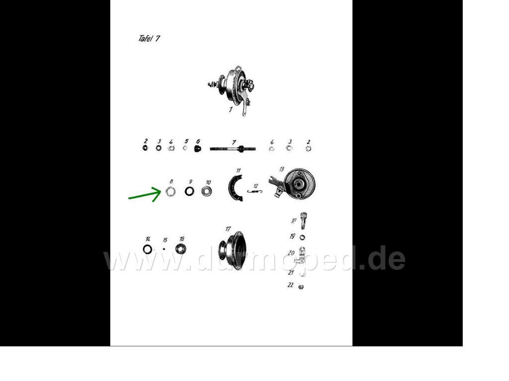

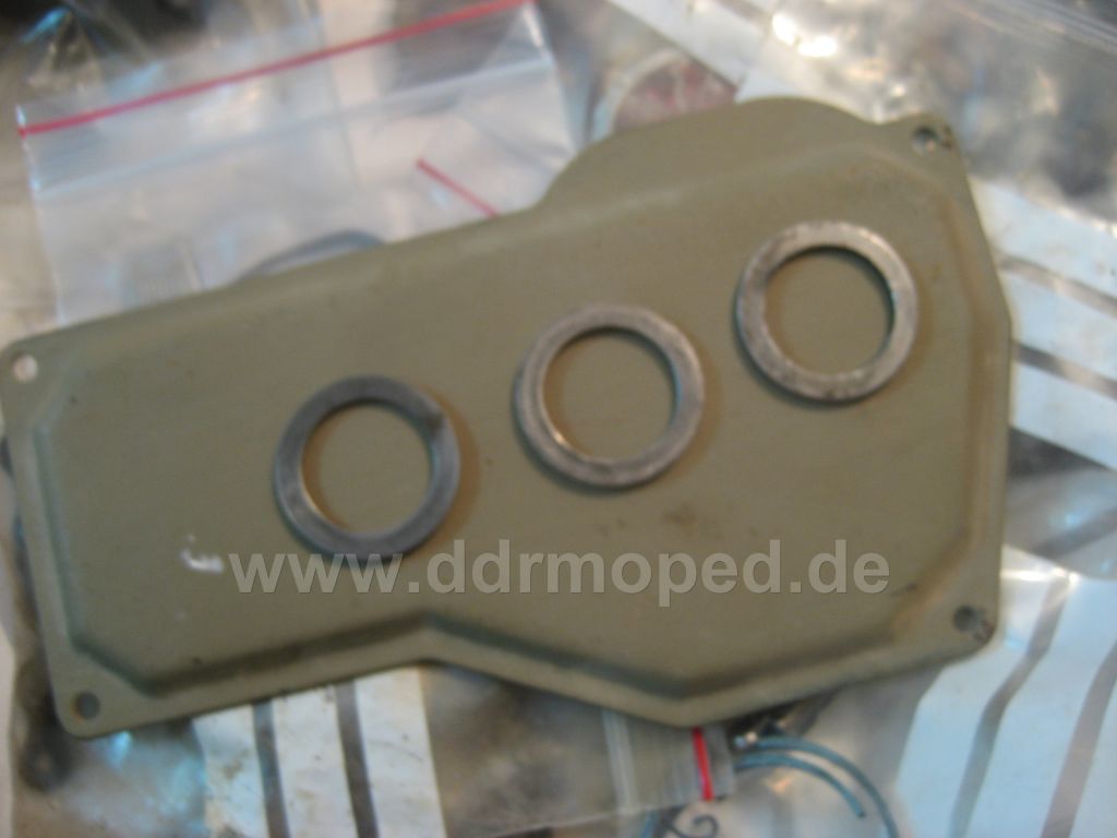

Ori

pic 2

This 2 Rings: from metal? from the motor? I say no. In the Motor you have 2 big rings: one under the clutch with 26mm and one under the big free-wheeler with 30mm.
Its possibil, the rings are from the front-axle (outside).

No Norbert No….
I even didn’t finish playing with your motor but first I must be "sure" of what you "think". laugh.gif
First thing the nut diameter of the magneto difference from sr1 to sr2 and some time lose.
The 28mm rings belong to the body but where? It from 2 mopeds
Ori
Cloyd
Geschrieben am: 08.07.2009, 21:41
Beiträge: 3467
Mitgliedsnummer.: 2144
Hi ori!
Can you measure how thik these rings are?
On first sight they look like spacers for the crankshaft and clutchshaft bearings.
But i dont think the engine would run good without them since the 2nd gear would slip while driving.

Thanks Toni
I suppose it number 8 but I don't get how?

Actually I have 3 of them in my spare parts box of pre assemble of two Sr1.
it not from the motor for sure.
