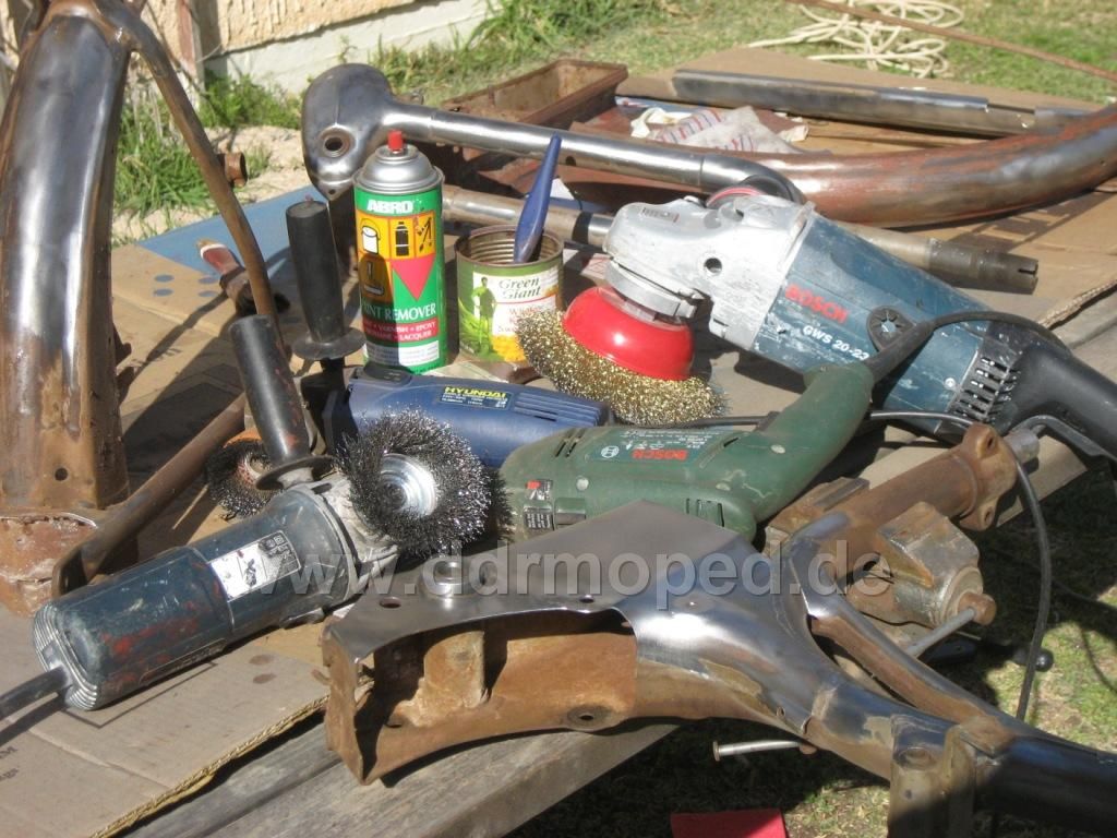

Hallo everybody
After watching the remarkable job that essermopi did with his Sr2e,
I decided to give up with the sand cleaning.
Feeling the material under my hand and hoping that my tooth will not falling apart.
I try to use paint remover that not tickle "kitzeln" at all.

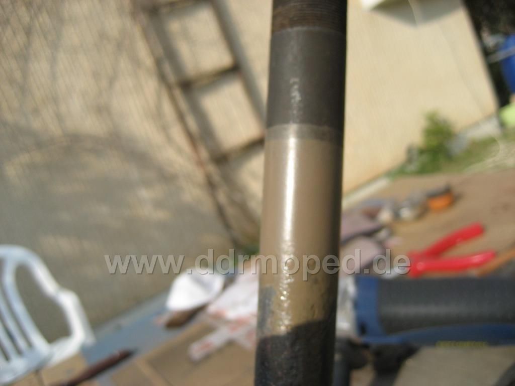

After spending hours in the internet and searching for Volvo that simson museum recommend and looking for R.A.L, Sikkens numbers I found the answer in my bike
Under the fuel tank and on the " Lenker" under the bike manufacture number area that not expose to the sunlight.
So my impression is that the true color is Khaki, Staubfarben yellowish-brown color and not beige grayish yellow light brown color that describe in the forum.

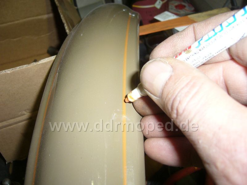

And of course I must to ask a question, that orange strips "Linien" if it made by pen and if yes
I need to know the name of it.

the original name of your color is "beige". doccolor has this original color in use. Again: contact him!
The color of lines is "terracotta" I must search a photo from my SR1 in beige and terrcotta...moment, please biggrin.gif

Thank you but my question was about the name of the pen
What kind of a pen is that because my Kesselflicker don’t now about it _uhm.gif
Feel good
Ori
schmoll-troll
Geschrieben am: 01.03.2008, 09:12
Beiträge: 574
Mitgliedsnummer.: 840
Mitglied seit: 28.09.2007
Hi ori_s,
Your Kesselflicker (*g*) will not be able to provide you this special color-pen. It's made by Sir Norbert himself! biggrin.gif
In another thread from Norbert it's written how to do this - with a pimped color-pen. Wait a second, I have to look, where....
Here...
Best regards
Daniel
