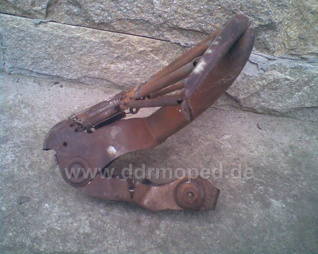

Hi everybody,
I find this SR-1/SR-2 seat in .... a scrap station. laugh.gif laugh.gif
According to me it's a "Sattel mit runder Gummifeder" but I'am not sure. Unfortunately Gummifeder (or Metallfeder) is missing.
What are dimensions of Gummifeder (or Metallfeder) for this seat.

Yeah, its not the "best condition" laugh.gif , but in this time well. You can make an original "Sattel mit runder Gummifeder"! This piece is one of it!
I must go into the garage and I will say you the dimensions. Or...is anybody faster than me... wink.gif
What next: good welding, rust removing, chrome, grey "dress" and etc.
I'll do my best.
Geschrieben am: 13.01.2011, 18:42
if it is possible use autogenous welding for repairing. The welding seam isn´t so brittle. Than you don´t have the danger that it cracks next to the welding seam. wink.gif

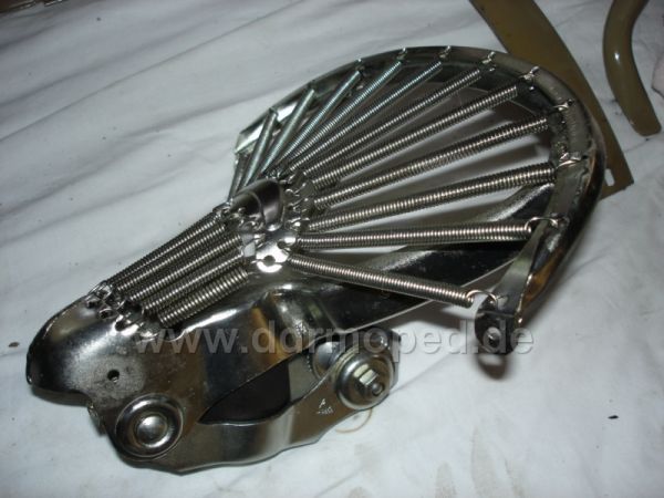

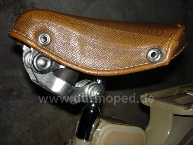

look at the picture. This is my complete saddle after the restauration.
Regards, Jürgen

Woow Beauty Sattel !!!!
No chrome no paint. "Metal" colour. What is the secret of this view ? Finery and lacquer after that ?

Konsti, this is the dimension of steel-spring! Searching is the dimension of the round-gummi.
