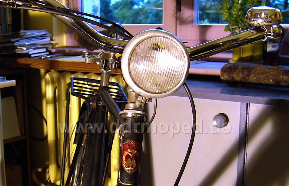

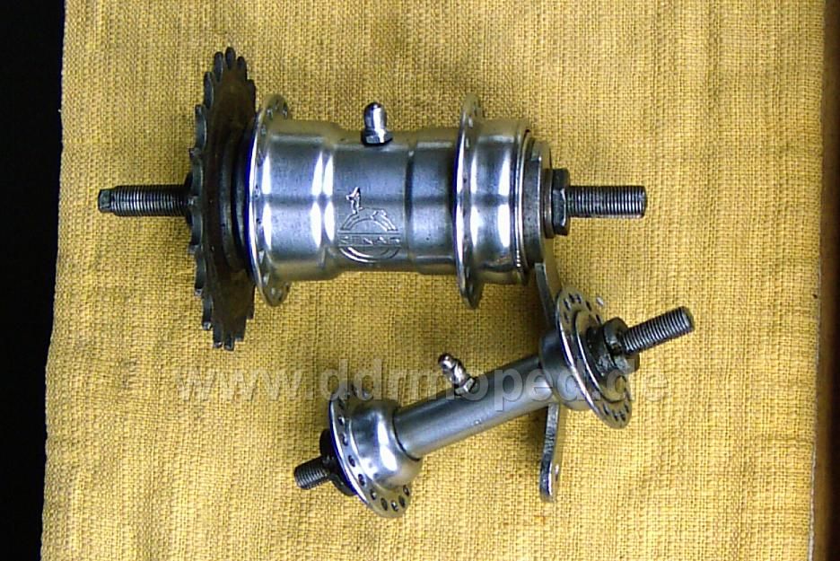

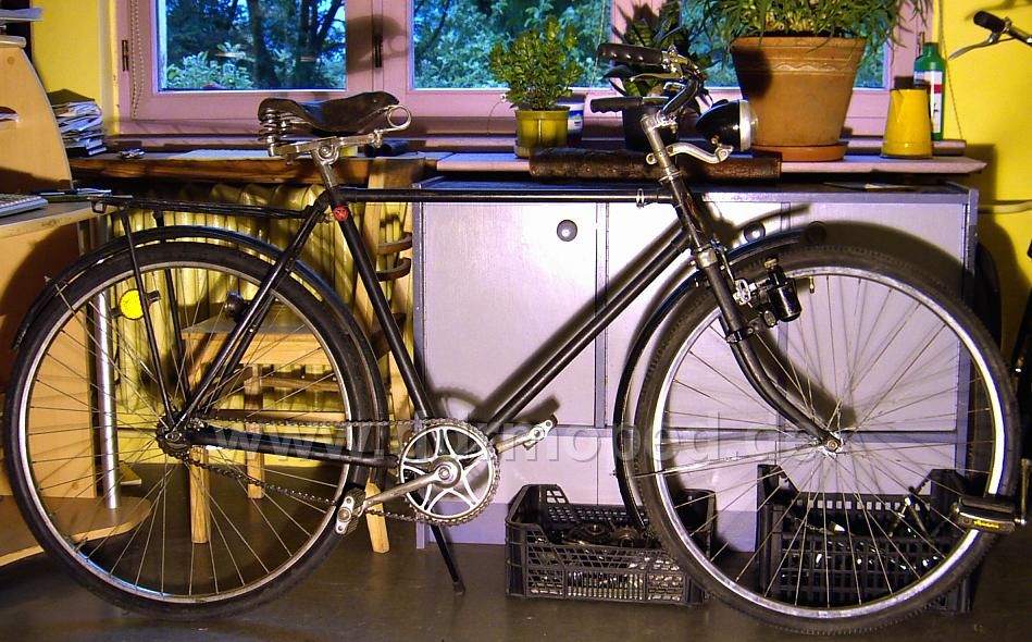

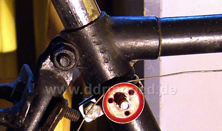

hallo; I would like to show You Move rhamen Modell 10, I think (num. 190591). I wish to remove this bike, but I'm not sure, the naben must be Renak signed 59, 60, or 61? greetings, Tomek
| Jeeves |
I think, he means "bring it back to the original condition". But, there is much more to do than only to replace the hubs.

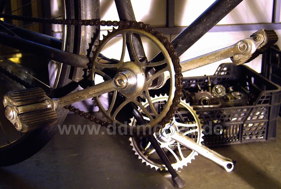

hallo; at first, forgive me my "broken english"; in my schooltimes most wanted was russian language (I'm guy from Poland)). This frame need wheels with Renak (FuS?) naben, replacement of kurbelblatt (sign. at the 2nd side: Renak 60) is needed too. Kette is connected two times... and many, many more...

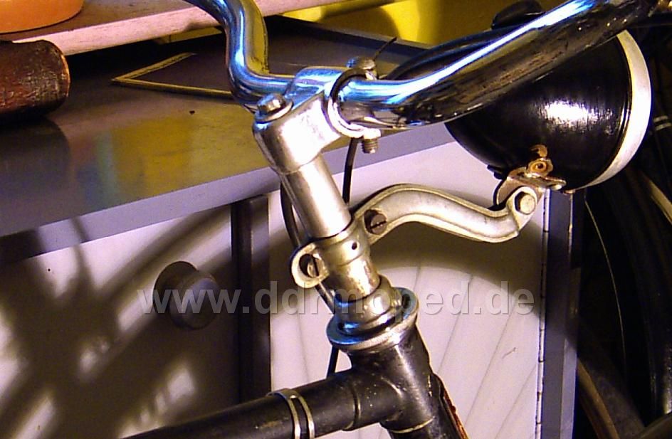

vorbau looks original; I found here information, that for Modell 10 was dedicated Lenker form 8. This one comes from my pieces (55 cm).

| QUOTE (Möve-Fahrer @ 22.06.2010, 15:30) | Hello Tomek!
Your Möve bicycle was built in 1961, it's a type 35-101. You need definitely another handlebar and hubs "RENAK 61". |
thanks Move -Fahrer; I'm worry, that I'm not able to reconstruct this bike properly. Market of using pieces is very small in Poland, and shipping from Germany is expensive. Maybe it is a reason to use erzatz pieces. Front hub 55, back 60. greetings, Tomek
