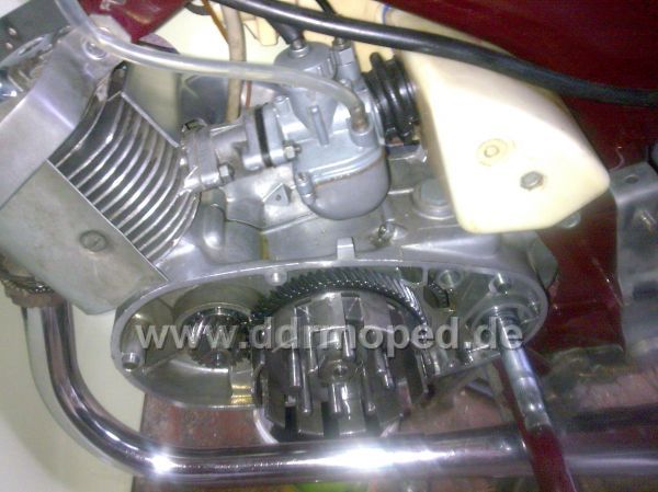

Zoli, the left side head is 7:1 (1,5 PS), the right side is 7,5:1 (1,8 PS)
I`ve never seen angle gears on Rh50 motors hmm.gif Only later on M-motors from Simson. I must ask. wink.gif
Zoli

Many thanks Norbert.
I guess that this drive is a home made modification which I found in a purchased engine. Now I will test it!
Chiers, Zoli.
Geschrieben am: 20.02.2010, 19:28
I think also: homemade. But good work thumbsup.gif
And the Rh motor is with this parts a little bit quiet. I think so.
Zoli

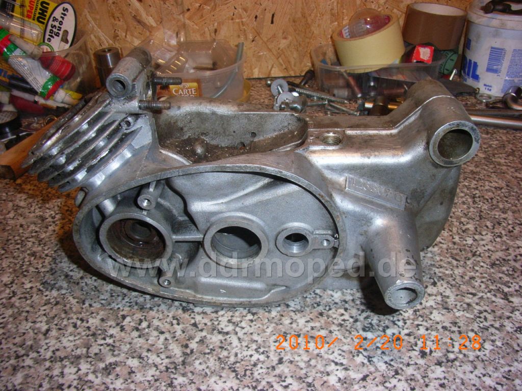

Could anybody tell me that this type of engine ( with no lipseal on pedalshaft) could belonged to an SR 1 or SR 2 or both?
When was the lipseal introduced on SR?
Kann jemand mir sagen, dass diese Art des Motors (ohne Simmering auf Pedalwelle) gehörte könnte ein SR 1 oder SR 2 oder beides?
Wann wurde die Simmering auf SR eingeführt?
Chiers, Zoli.

This angle drive gear is very interesting.
I wonder wich parts were used and is it possible to to it again?Is it easy to do or is some machine work needed?
regards, Toni

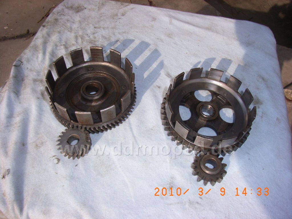

Here is the comparison between SR 1/2 and Star coupling.
The following modifications neede to fit the Star coupling to RH engine:
1. A taper must be machined into the small pignon.
2. An intermediate bronze bush must be used between RH coupling shaft and Star coupling basket.
3. The fingers of the Star coupling basket must be shortened.
Chiers, Zoli.

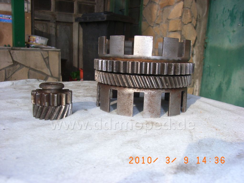

Zoli
Geschrieben am: 09.03.2010, 15:18
Beiträge: 59
Mitgliedsnummer.: 2890
Mitglied seit: 03.12.2009
An other view
Chiers, Zoli.

Hello Zoli!
I just had a Star clutch in my hands one week ago and took some measurements.
The result was, that it cant be mounted into the SR engine without special machining.
Its pretty much a big engineering job to make it work perfect.
I wonder how the power and the caracter of the engine is with that big modification.
regards, Toni
